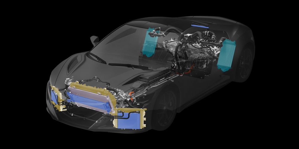

The all-new NSX employs 10 air-cooled heat exchangers responsible for cooling the front twin-motor unit (TMU), twin-turbo V6 engine, rear direct-drive electric motor and 9-speed dual clutch transmission (DCT).
The all new, twin-turbocharged 3.5- litre V6 engine at the heart of the Sport Hybrid SH-AWD power unit requires the greatest cooling and receives it through three radiators: one centre and two side units to get maximum airflow volume and efficiency. The centre radiator is tilted forward 25-degress, allowing the largest, optimised configuration that best utilises the inherent pressure gradient while maintaining the strict low centre of gravity targets of the NSX’s Advance Sports Package.
Condenser and power drive unit (PDU) coolers are efficiently packaged in front of the centre engine radiator.
The TMU is cooled passively through strategic use of air in the front motor room and by a heat exchanger mounted in front of the right engine sub-radiator.
The 9-speed DCT is cooled by two heat exchangers, one mounted in front of the left engine sub-radiator and the other in the engine compartment.
Twin-intercoolers located in the signature side intakes are used to cool the intake air charge.

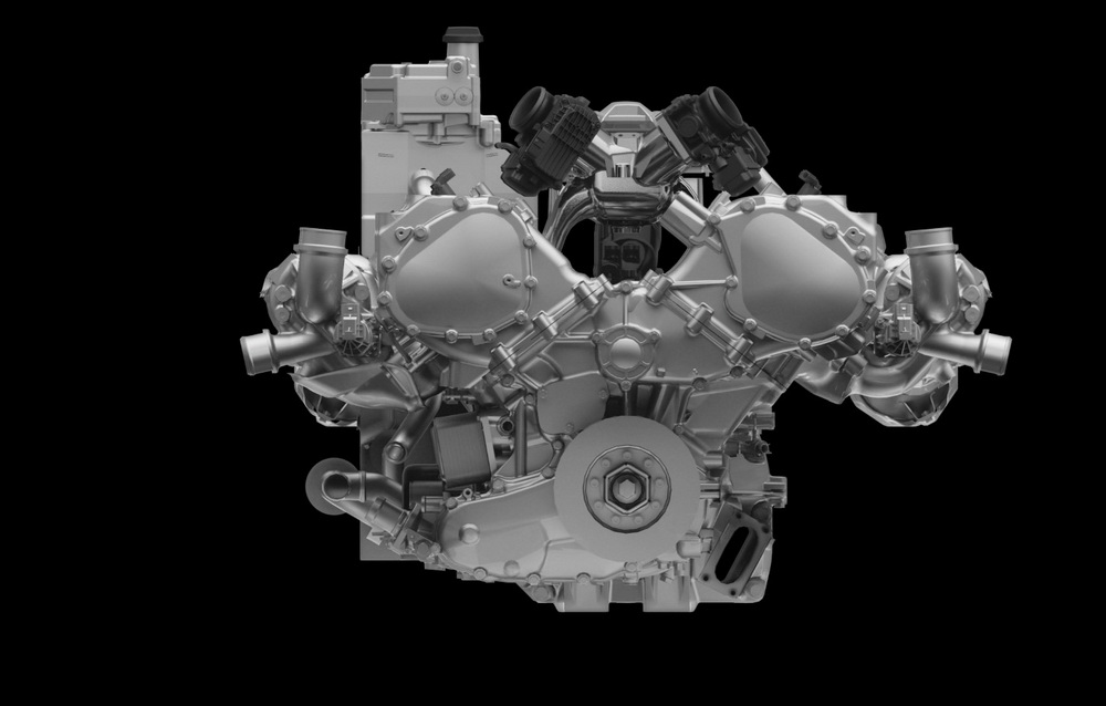

The new engine has a displacement of 3.5- litres and utilises pinnacle racing technology, applying both direct and port injection to its design.
The 75-degree V-angle and dry sump design optimises engine rigidity and further supports the NSX’s Advanced Sports Package by allowing the engine and components to be lowered in the chassis to the maximum extent, resulting in the lowest centre of gravity in its class. This also supports the advanced packaging of other engine components.
The engine’s dry sump design also helps maximise vehicle performance in high lateral-G conditions.

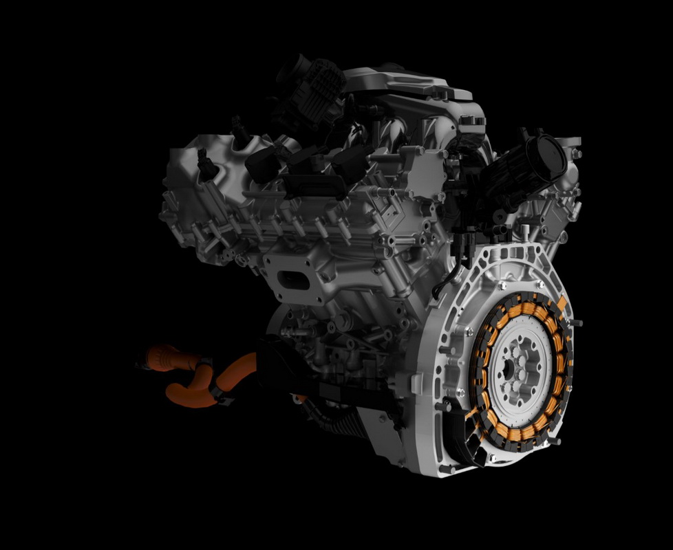

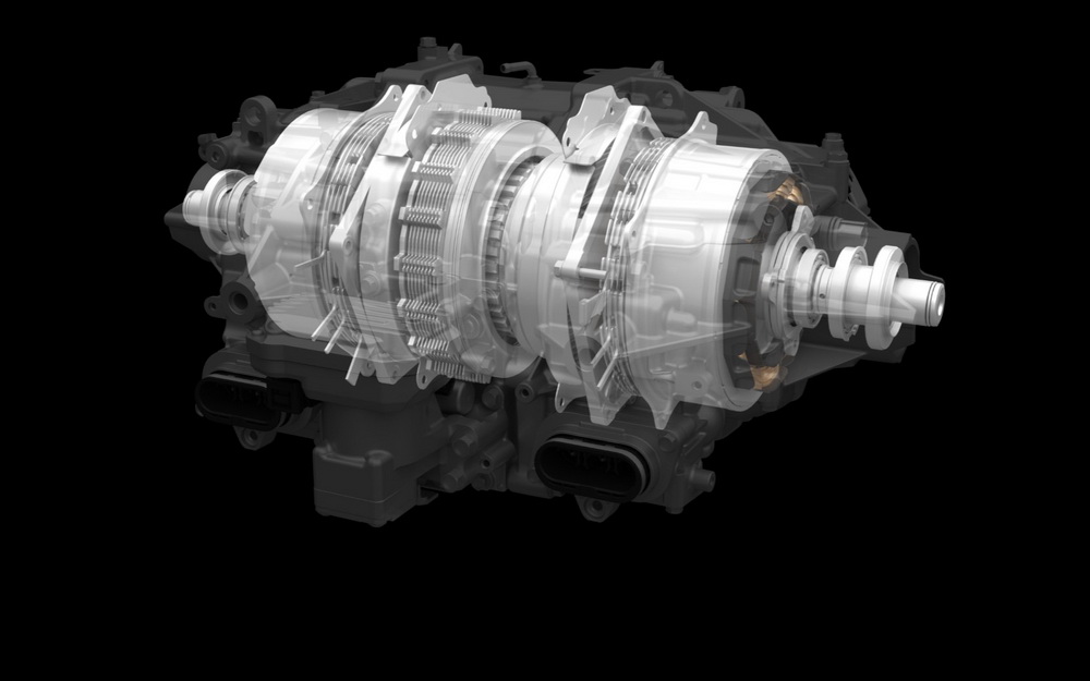

The rear direct-drive electric motor applies its torque directly to the crankshaft.

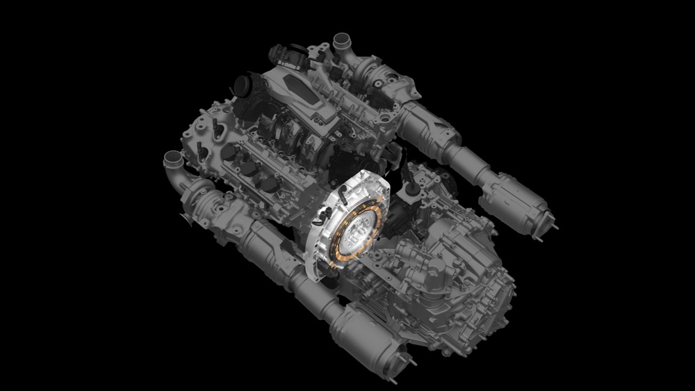

The 9-speed DCT’s main, counter, secondary and output shaft design maximises the advanced sports package through a configuration that lowers weight and helps to centre the mass nearer the driver.

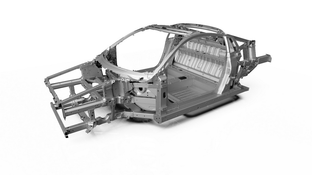

Multi-Material Body
Acura’s First Application of a Multi-Material Body with Space Frame Construction
Developing the Most Rigid-in-Class, Multi-Material Body
At the core of the NSX mission to deliver timeless sports car values is an aluminium intensive, multi-material space frame. This innovative space frame represents a next-generation leap in body design with class-leading technology that is exclusive to Honda within the automotive market. Based on internal data, the all-new NSX multi-material body is by far the most rigid in its competitive set.
While the all-aluminium monocoque body of the original NSX was ahead of its time, current aluminium and ultra high strength steel intensive body architecture has been taken to the limit for supercar design.
“For this new NSX development, anything and everything that could offer incredible base rigidity and lightweight design was on the table,” said Shawn Tarr, principal engineer and NSX body development leader. “We considered an all-aluminium unibody, carbon fibre monocoque and space frame designs and ultimately engineered a multi-material space frame because it offers the lowest weight and best rigidity, precision and hybrid powertrain packaging capability of any design.”
A key advancement in casting technology allowed the NSX development team to realise a quantum leap in body design, for the first time being able to engineer a vehicle with castings in key locations for rigidity, that also support the ductility necessary for placement within crush zones.
World’s First Application of Ablation Casting
The NSX heralds the world’s first application of ablation casting technology in the automotive industry. Ablation casting combines traditional casting methods with rapid cooling techniques to offer the design flexibility and rigidity of casting with the ductility and energy absorption characteristics of extruded material.
Traditional castings provide the ultimate rigidity in space frame and other body designs, but have traditionally suffered a major drawback: traditional castings are brittle. With the no-compromise performance goals of the NSX, a groundbreaking new casting method within the crush zones had to be used.
The ablation process allows the ultra-rigid castings to be located within the crush zones and to function as large aluminium nodes, or junction points. Aluminium extrusions are then inserted into sockets in the ablation cast nodes, which act as fixtures that hold the space frame in place during welding.
During the welding process, shorter stitch welds can be applied, enhancing the exceptional, repeatable precision of the NSX space frame construction by reducing heat deformation during the production process.
Ablation castings also enable traditional aluminium castings to be used at strategic locations in the space frame and as the primary mounting points for suspension and power unit components, in addition to being the reference and temporary attachment points during the highly accurate space frame construction process.
Full space frame construction and vehicle assembly are conducted on-site at the new Performance Manufacturing Centre (PMC) in Marysville, Ohio, providing a high level of quality control.
New A-Pillar Construction Technique
In addition to the world’s first casting technology, the NSX applies an all-new three-dimensionally formed ultra high strength steel A-pillar that provides next-generation rigidity and precise shape specification tolerances.
The previous generation NSX had a thin A-pillar that provided very good outward visibility. Reflecting this heritage with modern rigidity and roof crush performance requirements demanded this new, ultra high strength production method.

Total Airflow Management
Engineering a Next Generation Thermal and Aerodynamic Package via
To meet the challenge of the ambitious performance targets, radical packaging design and exotic styling for the next generation NSX, the development team had to totally re-imagine the thermal and aerodynamic engineering for this modern supercar so that maximum energy is extracted from the flow of air around and through the NSX with the highest efficiency.
This new total airflow management strategy supports component cooling, aerodynamic performance (drag and downforce) at a very high level without the use of active aero technology, while also contributing to even more dynamic styling.
Computational fluid dynamics (CFD) was used extensively during development to allow the U.S. based development team to maximise the performance of a power unit being developed in Japan. CFD models were run on computers totalling many years’ worth of computational uptime.
Thermal CFD was effectively used in two ways during development, first for the proof-of-concept in establishing heat management strategy at the earliest development stage and second, for continuous thermal performance improvement as the vehicle matured through development. Extensive involvement of thermal CFD with design engineers during the development enabled maximum design optimization.
Along with the use of advanced CFD, wind tunnel and real world testing, the development team also employed computerised lap-time simulation models of some of the world’s most legendary proving grounds that could then be run on chassis-dynamometers allowing testing and validation of computer models for thermal management.

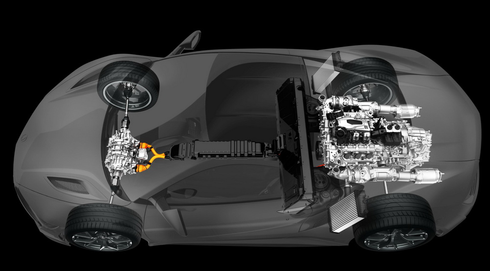

Sport Hybrid Super Handling All-Wheel Drive
A new handling paradigm decades in the making
The groundbreaking Sport Hybrid SH-AWD dynamic torque vectoring technology applied to the all-new NSX represents research and development that has been ongoing for well over two decades.
Next-generation torque vectoring
Honda has been continuously refining its advanced torque vectoring technology while in parallel developing new ways of accomplishing the timeless sports car values of lightweight, rigid chassis and potent powerplants. This all-new Sport Hybrid SH-AWD represents a system injected with more electric power, delivered more directly, managing more internal combustion power than any system Acura has engineered to date.
In keeping with the development team’s ‘human- centred supercar’ concept, the new NSX and its Sport Hybrid Super Handling drivetrain were truly engineered from the driver out. While the NSX provides a new sports experience with ‘on rails handling,’ its Super Handling technology was optimised to enhance the driving experience by responding instantaneously and intuitively to the will of the driver.
Super Handling is brought to its pinnacle form in NSX where the strengths of electric motors – delivering zero delay acceleration – allows the NSX to offer dynamic torque vectoring even at low vehicle and engine speeds.
Super Handling logic has progressed along a parallel path with hardware. While many advanced automotive technologies are focused on feedback, measurements of how the vehicle is reacting, NSX uniquely applies additional technology to focus on accurately responding to driver input through immediate, precise application of torque at each wheel at any moment.
Using cutting edge computer-aided engineering (CAE) optimisation software, engineers created a double-wishbone, double lower control arm front suspension that decouples the twin-motor unit (TMU) torque from the driver’s experience at the steering wheel, providing timeless sports car steering communication to the driver with a new experience of on rails handling provided by the precise torque vectoring of the TMU.
Variable gear ratio steering is applied to further enhance the confident, race-ready driving dynamics of the all-new NSX.

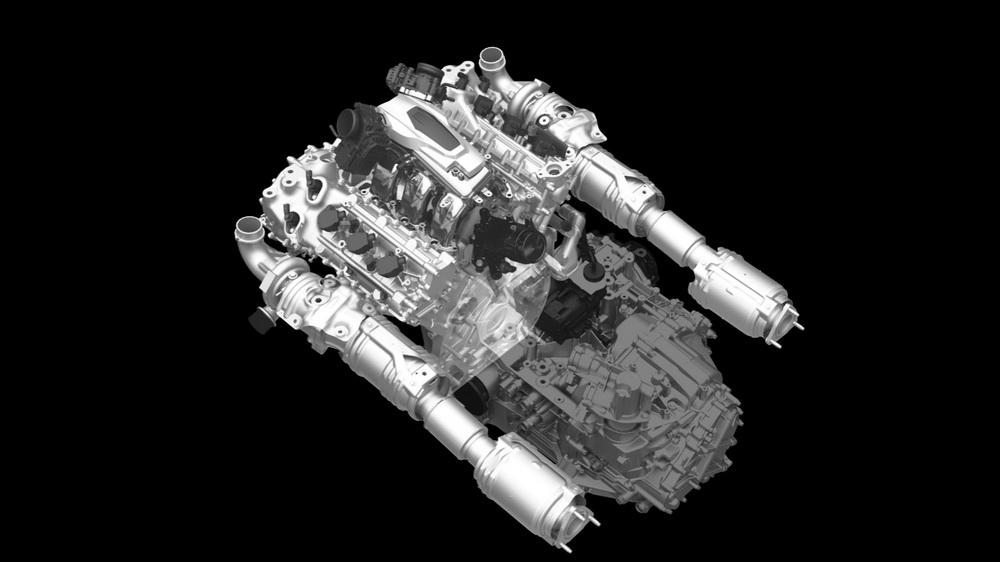

Powertrain
Sport-Hybrid SH-AWD Power Unit
Powering the Sport Hybrid Power Unit with Racing Technologies
As announced at the 2015 North American International Auto Show, the new NSX will utilise an all-new power unit from a clean sheet design. At its heart is an all-new longitudinally mounted twin-turbo V6 engine that is mated to an all-new, Honda developed 9-speed DCT with an electric motor that applies its torque directly to the crankshaft for higher output with immediate power delivery to the rear wheels.
