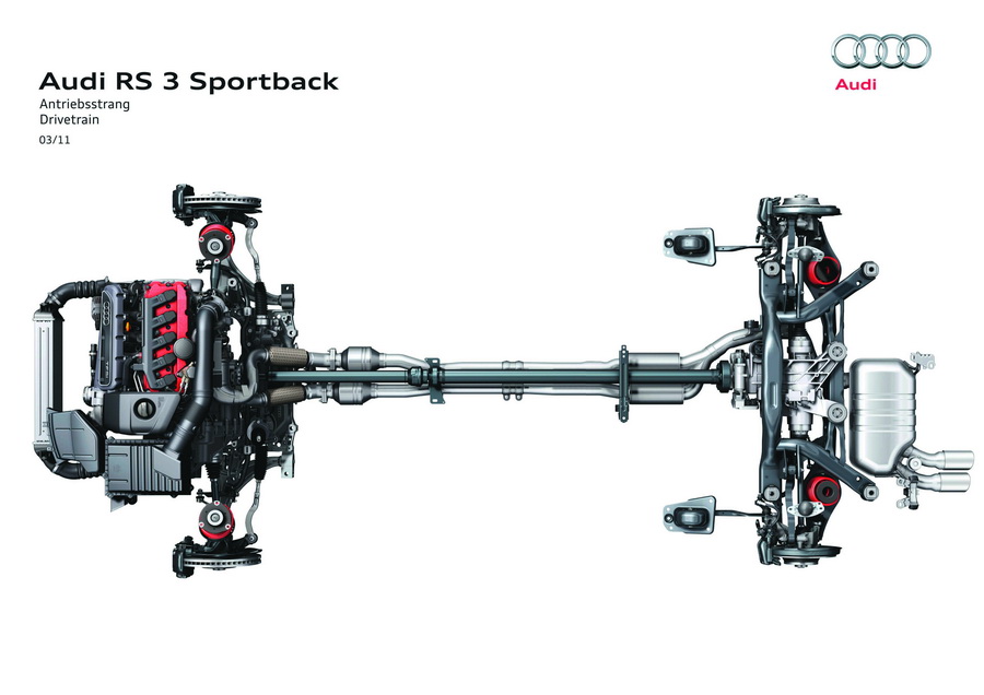

Il me semble que la RS3 conserve un Haldex.
The central component of the quattro drive in the Audi RS 3 Sportback is a multi-plate clutch that is controlled electronically and actuated hydraulically. In order to achieve a favorable axle load distribution, it is mounted at the end of the propeller shaft upstream of the rear differential. Located in the interior of the clutch is a plate package bathed in oil. The metal friction rings are arranged in sets of two, one behind the other. One ring in each set is permanently engaged with the housing that rotates with the propeller shaft, while the other is permanently engaged with the output shaft to the rear differential.
Under normal driving conditions, the clutch directs the majority of the engine power to the front wheels. If a loss of traction occurs there, the clutch is able to continuously redirect the torque input toward the rear by pressing the clutch plates together within a few milliseconds. A pressure accumulator helps the electric pump build up the oil pressure required for this process, which can exceed 100 bar. If a wheel on a given axle begins to spin, the electronic differential lock (EDL) brakes it as necessary.
A ma connaissance, Audi n'a fait de "vrai quattro" qu'avec des moteurs longitudinaux.

ze_shark a écrit : Il me semble que la RS3 conserve un Haldex.
So, while we all know that this all-wheel-drive land dart would be just that much better with a sport rear differential and torque vectoring, the all-electronic Sport ESP system on the 2011 Audi RS3 Sportback working with the Haldex 4 multiplate clutch holds its own in considerably convincing fashion.
ze_shark a écrit : A ma connaissance, Audi n'a fait de "vrai quattro" qu'avec des moteurs longitudinaux.
Ce que la différence d'usure entre les pneus avant et arrière à seulement 3000 km confirme également...

Merci pour l'info. Mais alors quelle est la différence entre une "pur" Quattro et le système Haldex de la RS3 qui permet un 100% en propuslion?

Un 4x4 permanent et une motricité 4x4 "si nécessaire" ?

La RS3 est en haldex, et effectivement il n'y a que les moteurs longitudinaux qui ont droit au torsen.

Haldex :
Transmission intégrale quattro du type Haldex, ce système utilise un embrayage hydraulique doté d’une pompe gérée électroniquement. L’unité de commande modifie en permanence, le passage du fluide et par conséquent le report de force motrice sur l’avant ou sur l’arrière. Le pourcentage de répartition peut varier de 97/3 à 3/97. l’Haldex est dit préventif : son cerveau module le flux d’huile dans le différentiel en fonction des actions sur l’accélérateur, le volant, la boîte, les transferts de masse, etc… Cet aspect anticipatif du système peut apparaître plus sûr en usage courant.
(Source Audi.fr) ®
Torsen :
Transmission intégrale quattro du type Torsen, ce système utilise un principe mécanique : un différentiel à vis selon un coefficient de blocage pré-établi : 1:3, 5 chez Audi. Dans les faits, cela se traduit par une répartition variant de 25/75 à 75/25. Le Torsen (pour Torque Sensing ou « capteur de couple ») réagit, par définition, aux contraintes : c’est le train le plus résistant, donc le plus adhérent, qui supporte la plus grande puissance moteur. Écueil induit : le système est dit réactif, puisque dépendant du niveau d’adhérence des quatre roues.
(Source Audi.fr) ®
